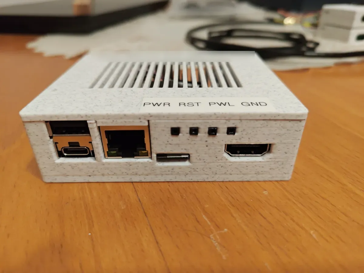

jrowny's box for the Waveshare ESP32-P4-WIFI6-POE-ETH, with thicker walls, a microSD slot, an SMA antenna cutout, more vents and four holes for the power and reset wires.
Model on MakerWorld Discussion #54
Photo by the author.
A remix of jrowny's enclosure by @dangamboa, who runs ESP-KVM on this board (#54). The walls are thicker, and there are cutouts for the microSD card and the Wi-Fi SMA connector.
The four holes on the front take wires to PC817 boards inside: power and reset buttons, the power LED and ground, labelled PWR, RST, PWL and GND. That is the power control wiring, brought out of the box. About 45 g of PLA.
On PoE, cut the 5 V wire in the USB cable to the target. The board's page says why.
