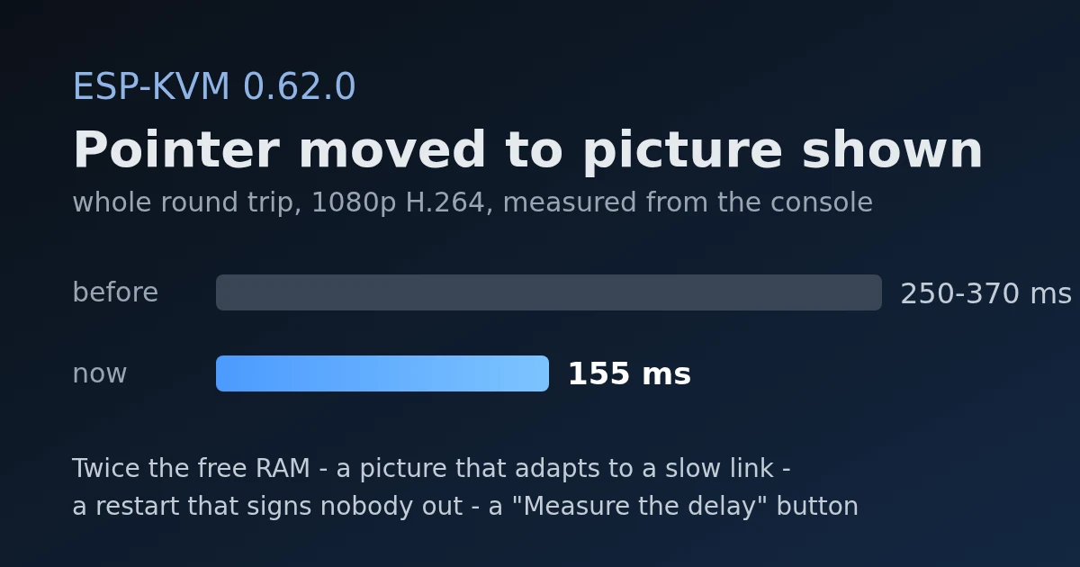

0.62.0 - 155 ms from your mouse to the picture, and twice the free memory
This release is mostly about speed and memory, and every number below was measured on the devices.
A button that measures the delay
The Video readout (click the video figures in the status bar) has a new button, "Measure the delay". After a few seconds to let go of the mouse, it moves the target's pointer back and forth and times how long until the picture in the browser shows it. That is the whole way round: the browser, the network, the device, USB, the target drawing its cursor, HDMI, capture, the encoder and the decoder. Beside it the readout shows how much of that is the device and how much is the browser.
It needs a visible pointer and a still screen, and says so when it cannot see one.
H.264: 170 ms less
The first thing the button found was that H.264 was much slower than MJPEG - 250 to 370 ms against 160. The device took 75 ms of that. The browser took 174.
The ESP32-P4's encoder makes no B-frames, but the stream did not say so, and without that Chrome's decoder held about four frames back before it showed one. The device now writes "frames are never reordered" into the stream's header, and the console adds it to a stream from older firmware. The browser's share went from 174 ms to 2, and the whole round trip at 1080p to about 155 ms - the same as MJPEG. Since 0.70.0 it is 58 ms at 1080p50 and 86 ms at 1080p30.
On the M5Stack Unit PoE-P4, where H.264 runs at 5 to 16 fps, four frames held back were most of a second. There the round trip at 720p is now about 185 ms.
The whole round trip, mouse moved to picture shown:
| Board | Video | Before | Now |
| Function EV | 1080p H.264 | 250-370 ms | about 155 ms |
| Function EV | 1080p MJPEG | about 160 ms | about 160 ms |
| M5Stack Unit PoE-P4 | 720p H.264 | not measured | about 185 ms |
