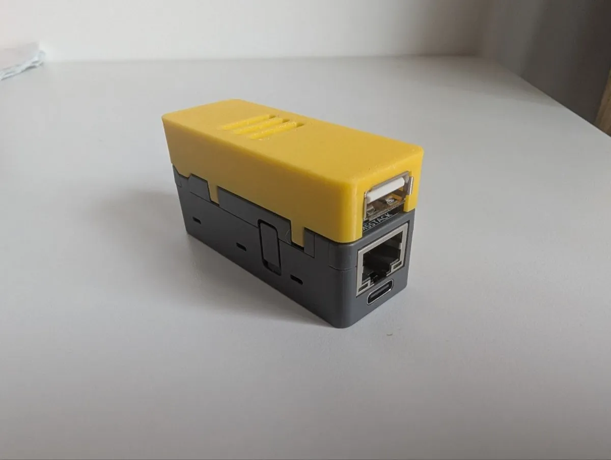

I drew a case for the add-on that matches the Unit PoE-P4 housing: same width, same corners. The two sit together as one block.
The other end: the add-on's USB-A port above the Unit PoE-P4's Ethernet and USB-C.

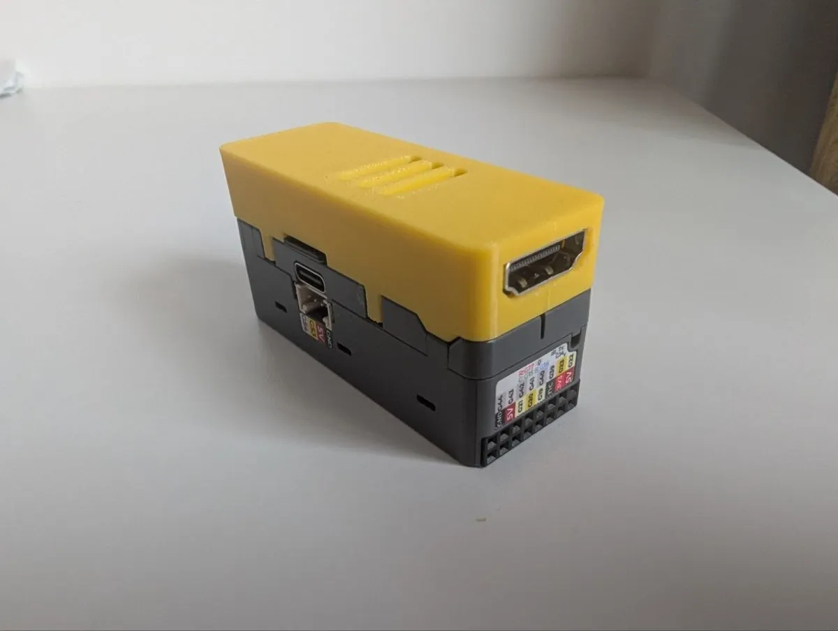

HDMI comes out of one end and the USB-A port out of the other, and there are vent slots on top. Ethernet, USB-C and the side ports of the Unit PoE-P4 stay free.

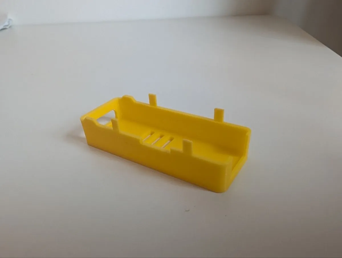

The case on its own, upside down: one part, with four tabs along the edges.
It is one printed part and needs no screws: four tabs along its edges go into the slots of the Unit PoE-P4 housing and hold it there. The tabs are thin, so press it on gently.
The Add-on Display Out has the same outline, so the case should fit it too; I have only tried it with the Display In.
