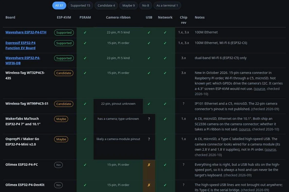

Part of the table on /boards/all/ - supported boards, candidates, maybes and two Olimex boards that cannot work, with a column per need.
A question I get a lot: "I have this P4 board, will ESP-KVM run on it?" The answer used to be spread over the catalog, a table in the porting guide and old issue threads. Now it is one page: 37 boards, each with a verdict.
A board needs four things, and the table has a column for each:
  • 32 MB of PSRAM. Capture, the encoder and TLS do not fit in 16.
  • A camera connector the capture board's Raspberry Pi ribbon fits. A connector alone is not enough: some boards have their own camera on it, some use a pinout nobody has published.
  • The P4's high-speed USB on a connector it can drive as a device. That port is the keyboard and mouse the target sees.
  • A network: Ethernet, or an ESP32-C6, C5 or C61 for Wi-Fi.
Green means the board has it, orange means it does not, no colour means nobody knows yet.
Some of the "no" ones look perfect on paper. The Olimex ESP32-P4-PC has the memory, the Ethernet and a Pi camera connector, and then a USB hub on the high-speed port, so it can only ever be a host. The LILYGO T-Halow P4 has 8 MB of PSRAM and brings USB out only on an M.2 edge.
The most promising new one is the Wireless-Tag WT32P4C5-43S, out this month: everything is there on its published schematic, except which pins drive the camera's I2C. If you have one, the page has a button to tell me how it went.
