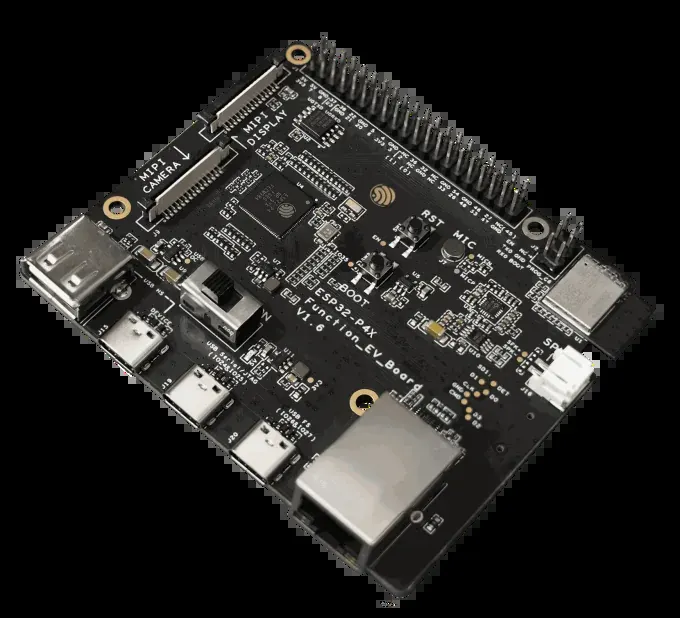

The ESP32-P4 comes in two silicon families, and an image built for one will not start on the other - the header carries both a minimum and a maximum revision. The Waveshare ESP32-P4-ETH is an older revision; the Function EV board is rev 3.2. So they cannot share an image, and both have to be built.
